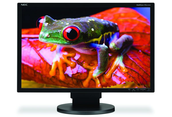

Quelle: engadget.com
Impressed by the NEC EA261WM's frog-displaying abilities but think it's about four inches too much for you? Then good news! NEC has now introduced the MultiSync EA221WM, which boasts many of the same "premium" features in a slightly more desk-friendly 22-inch size. That includes a 1,000:1 contrast ratio, a 5 ms response time, a four port USB 2.0 hub, and NEC's trademark ECO Mode and carbon footprint meter, to name a few, although you will have to make do with a drop to 250 cd/m² brightness, and a 1680 x 1050 resolution instead of the full 1,920 x 1,200 on the 26-inch model. On the upside, the EA221WM's $390 price tag is a good deal more affordable than that of its larger counterpart, and you'll be able to get your hands on it sometime this month.
___
S-PVA Panel?
