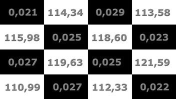

"Het contrast, gemeten volgens de ansi-methode, is met een verhouding van 4628:1 prima dankzij keurige zwartwaarden." -Tweakers NL
"The VA-type LCD panel on the Sony KD-55X8505C displayed a convincing shade of black by 4K LED LCD standards. With peak luminance pegged to our normal dark-room target of 120 cd/m2, black level measured 0.048 cd/m2 on a 4×4 ANSI chequerboard pattern" - HDTV Test UK
"Two of the most key factors in producing great pictures are pretty much there right from the off with the KD-65X8505C; contrast and black level performance is very good – we measured black at 0.024cd/m2 and an ANSI contrast ratio of 5400:1, which is certainly some of the best performance you’re going to see with an LCD TV." - AV Forums UK
"Black: 0.026 cd/m2
White: 100.8 cd/m2
Contrast: 3877 : 1This TV's contrast is very good, so the blacks are deep.
To measure the luminance of black, we use a black and white checkboard pattern. We calibrate the television to have a white luminance of about 100 cd/m2 and then we measure the luminance of a black square on the same picture." - Rtings CA/US -
Vielen Dank furs Test
. Wie soll Mann die blickwinkel Ergebnis eigentlich interpretieren? Und wieviel Grad ist "seitliche Perspektive"(Wieso sind eure ANSI kontrast Ergebnissen meistens so weit entfernt von alle andere Reviews [HDTV Test, AV Forums, etc. etc. etc.]? Zum Beispiel, 55X8505C 469:1 ; HDTV Test ~2500:1 ; AV Forums 5400:1 65" ; Flatpanels 3290:1 65" ; Rtings 3877:1)
Danke im Voraus!
