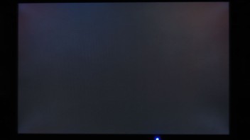

Hi traveller,
O.K. my dark frame picture was taken with 1/2", aperture 1:4 and monitor brightness at 100%(only for the picture, normally set to 72%).
I was too lazy to use a tripod for a slower shutter speed
Finally I have taken another dark frame with 1,3" shutter speed, please look at the bottom.
Now it looks cloudier but the "X-factor" is still on the mild side.
In normal use you will never see it this way!
Surprisingly the "color shifting" again shows its grinning face in this long term exposition.( f..k!!!! :O)
Greets
Michael

Anbei übrigens auch mal ein Schwarzfoto von mir, womit ich eigentlich ganz zufrieden bin
Deine Fotos im englischen Forum sind sehr aufschlußreich und unterstreichen die Theorie ,das es scheinbar doch unterschiedliche Panels geben muß!
Michael
