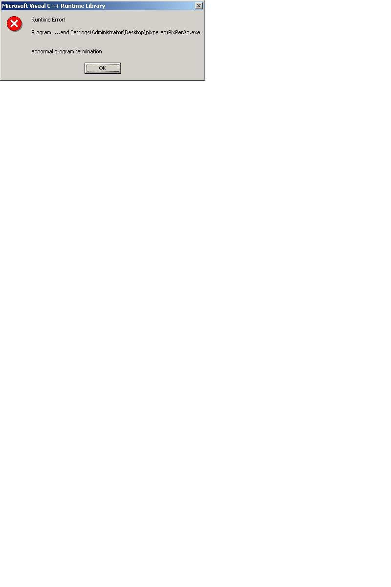

I am getting the following error whe running pixperan.
Anyone can help?
Thanks!
Anyone can help?
Thanks!

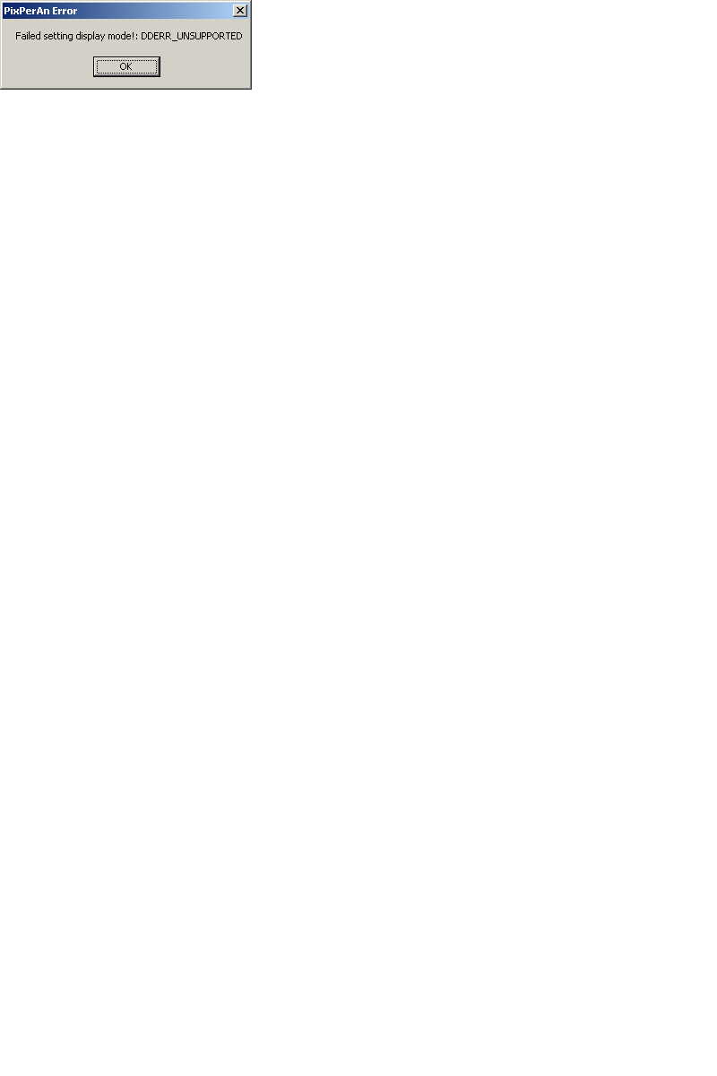

The ERROR is :
DDERR_UNSUPPORTED
Hello lawrence,
Pixperan needs a 32 bit mode.
If your desktop is not already set to 32 bit, pixperan tries to initialize a 32 bit mode of the same resolution as your desktop resolution. On most PC's this is no problem, but if this is not supported by your hardware or software by some odd reason (for example if the graphics card is quite old), it will fail.
If the problem is that your graphics card's memory is too small, you could try a lower desktop resolution (for example 1024x768 instead of 1280x1024) before starting PixPerAn.
With best Regards
Wilfried
