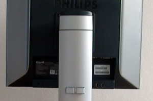

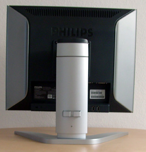

Phillips 190p7es schief und krumm montiert (english speaking)
  • Better to answer in english or german? I'll try first in english ;)
    Thats a quality problem of a certain range of 190P7ES, where the notch of the Pivot-joint is too short to turn the TFT completely into horizontal position.
    The only thing that could help is to demount the display and to widen the notch of the joint with a file or something like that.
    I try to make it more descriptive: At your 190P7ES the notch is like this:
    '+. <--- wheras here the length of the notch is too short and the display stops when reaching the "." in the "graphic" above
    And it should be like this:
    '+._
    I hope you understand what I mean.
