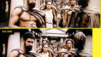

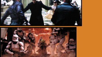

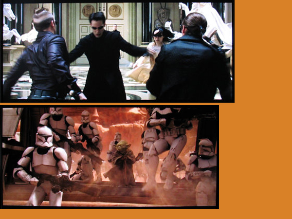

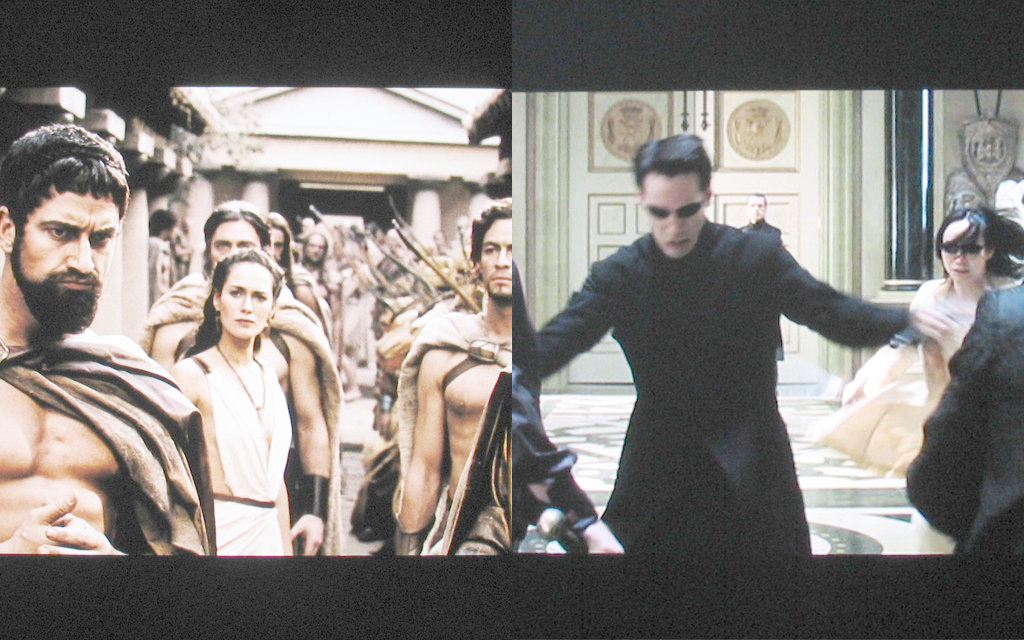

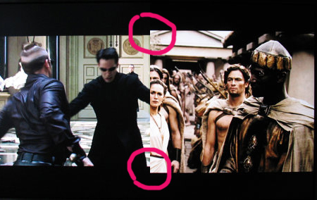

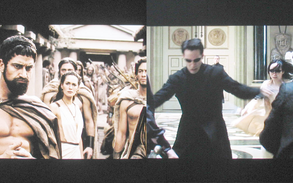

  • I have to share my disappointmet with the the Dell 3008 test results in the area of Video and DVD.

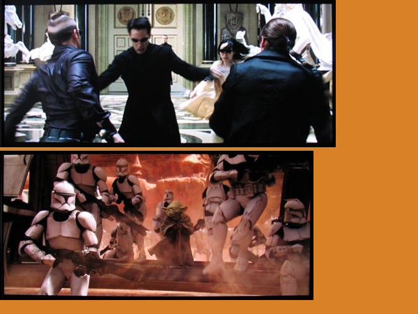

    Please look at this: "Scene from the Blu-ray film "300" (2.35:1 Cinemascope- format), played on PlayStation 3 via HDMI."
    The movie is 2.35:1 but what the Dell 3008 shows is NOT 2.35:1 !
    Compare with this: "Scene from the film "Matrix Reloaded" (2.35:1 Cinemascope format), played on PC via DVI-D."
    See attachment #1 for comparison.
    Obviously Blue-ray image is either cut from the sides or stretched vertically.
    In both cases this NOT Full HD (1080p).
    I know pretty well that this is a typical problem for many so-called Full HD monitors which in fact are cheap displays with poor scaling ability.
    Now I am looking at the Dell 3008 closely to find out if in this case we have a true all-around multimedia monitor (for the first time from this brand!)
    Disappointment!

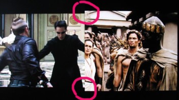

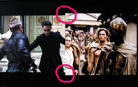

    How much is missing? Let's scale the undistorted image from PC up to the height of another distorted image (Scene from the film "Star Wars: Episode II" (2.35:1 Cinemascope format), played on PlayStation 3 via HDMI in PAL standard.)
    I do not know how the reviewers could miss this fact.
    See attachment #2.

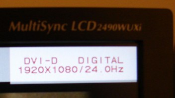

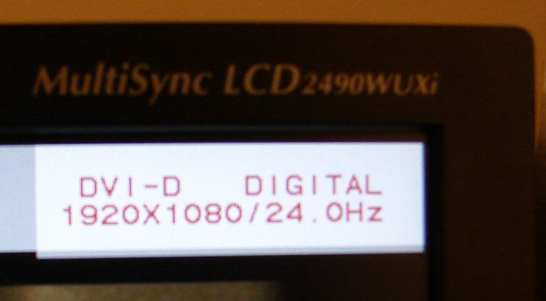

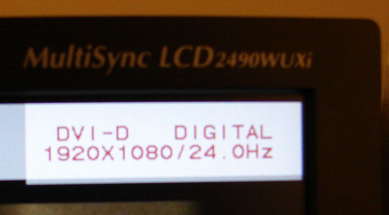

    I came across this Dell's problem when tried to play 1080p HD-DVD on the Dell 2707. Multiformat HD player LG played 1080p at 24Hz. The Dell 2707 showed nothing. At the same time a reference monitor next to it showed 1080p at 24Hz without any problem.
    See attachment #3.
    So, if somebody is planning to buy the Dell 3008 he will have to buy another HD player just because this "perfect all-round multimedia monitor" cannot play regular 1080p 24fps?

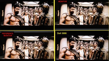

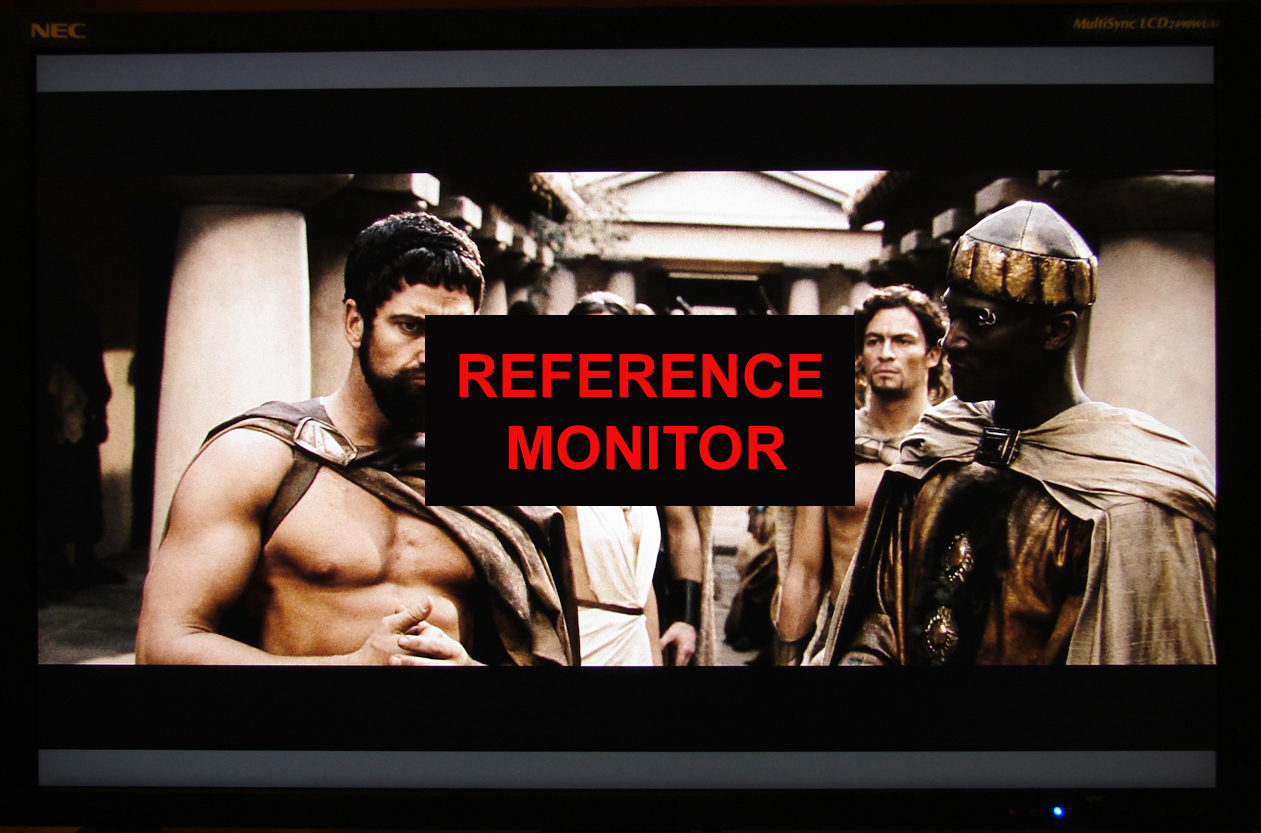

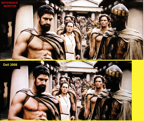

  • Dear Andi, thank you for the reply.
    I have done a little more homework.
    You gave me a reason to extend my HD library. So Blue-ray "300" is on my display now. This is a reference monitor.
    I open the same scene from "300", take a photo and compare with prad.de Dell 3008 review image.
    Quote
    slight differences may appear in the photos because of the distance at which the camera is placed, slight tilting of the panel, etc.
    OK, I'm not going to compare color reproduction detailes "Dell 3008 vs proper image". What I'm doing is simple geometry. For that purpose published photos are well suitable.
    Let's go step by step.

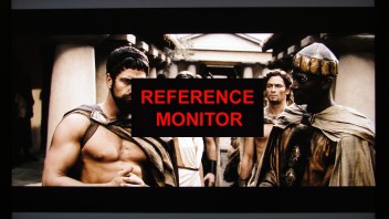

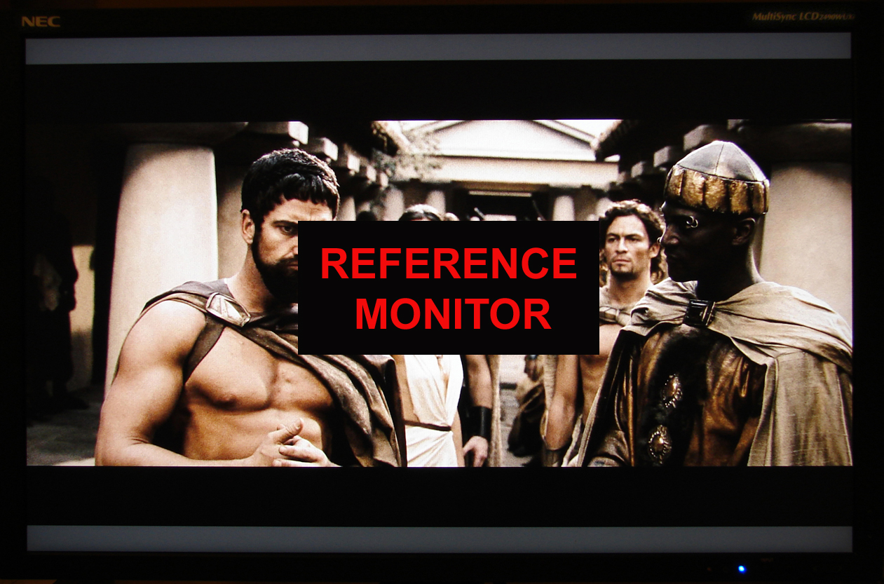

    1. To prevent any doubts - the full image of the reference monitor. Attachment #1.
    2. See Attachment #2. Monitor screen format check.
    The whole viewable areas of the Dell 3008 and the reference monitor compared.

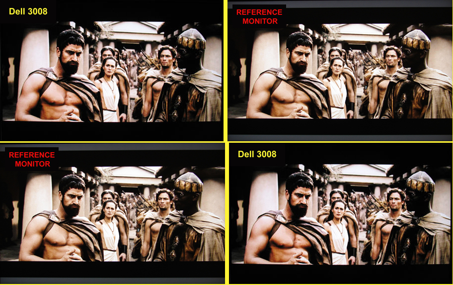

    Result: pictures from prad.de are valid and good for a comparison - they demonstrate correct proportions of the panel - about 1.6:1. The difference ("the camera is placed, slight tilting of the panel, etc") is about nothing (somewhat 1.585: 1 vs 1.59 or so). It does not matter if any color tone difference is present.
    What does matter - proper video format!

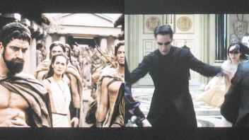

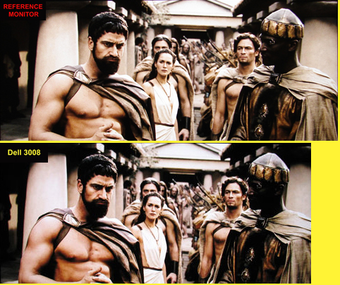

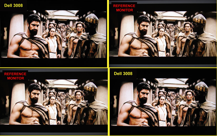

    3. Now we can compare the HD image itself.
    Attachment #3.
    It's obvious! Now we can see what is missing on the Dell 3008.
    The picture on the Dell 3008 is cut from both sides. Can we suppose that prad.de reviewers intentionally cut mages before publishing them? Never!
    Therefore this is the proof that the Dell 3008 cuts video.
    "300" is 2.4:1 (information about 2.35:1 in the review is not correct).
    The reference monitor shows true 2.4:1
    The Dell 3008 shows ~2.2:1. About 9-10% of the image is missing.
    Does it say only about a missing part of the image for the Dell 3008?
    No!
    It means that the rest of "Full HD" is always interpolated unless the reviewers kindly provide us with the image of 1:1 mode 1080p playback dot-for-dot 2.4:1.
    Back to the Dell 3008 review conclusion.
    "Scaling in video mode is also perfect. No matter what input the image signal is played over, the result is convincing, the aspect ratio correct."
    According to the information we have so far, this statement is absolutely wrong. The Dell 3008 suffers the same scaling problems that many cheap monitors do.
    I think prompt correction of the mistake in the review would be only a plus for such a respected resource like prad.de
    Thank you.

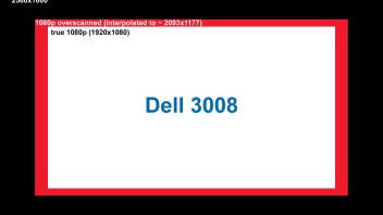

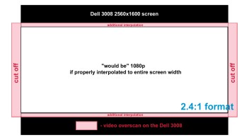

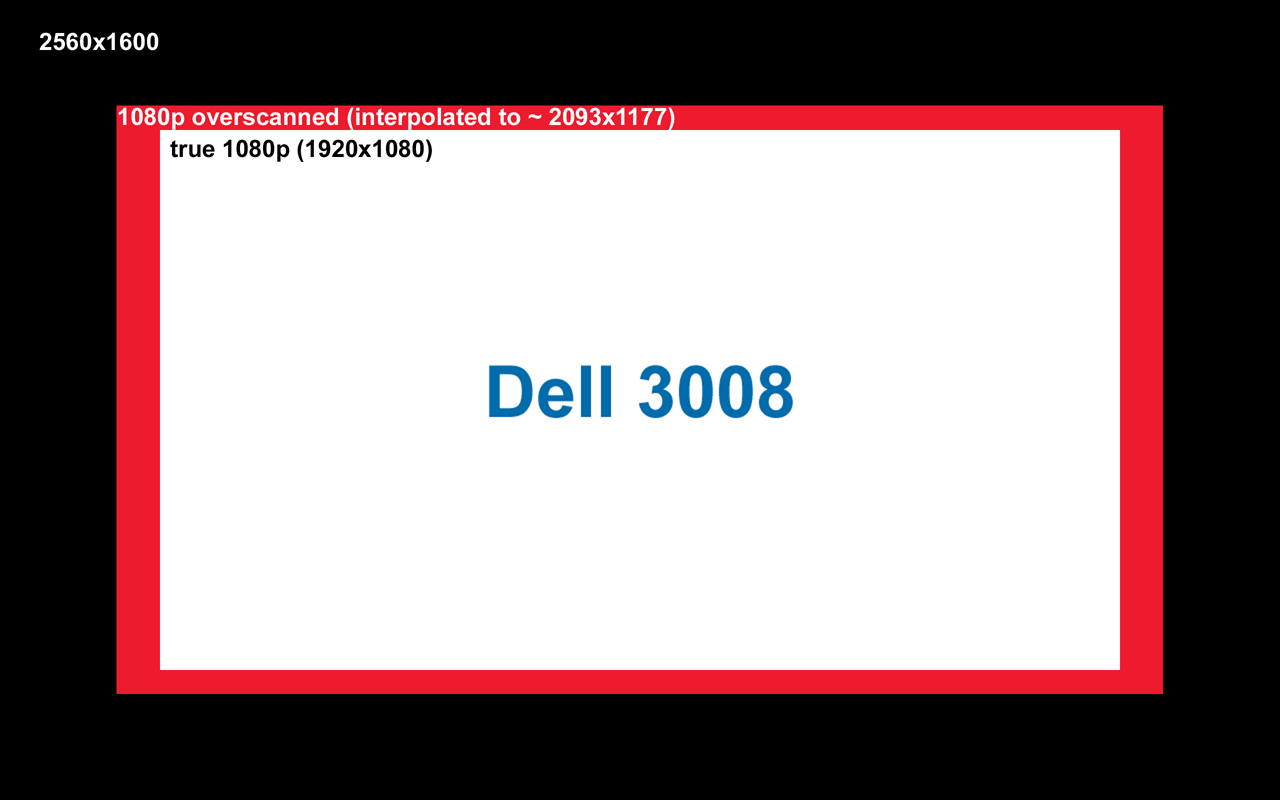

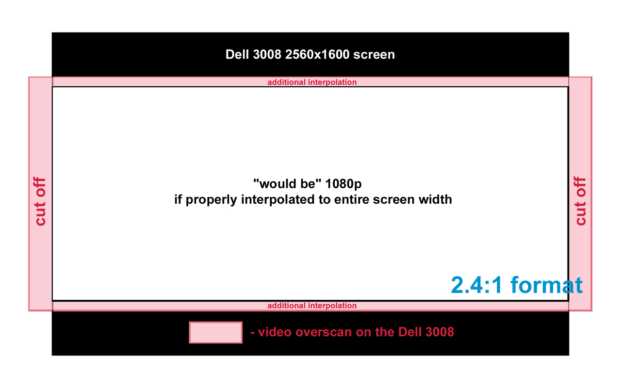

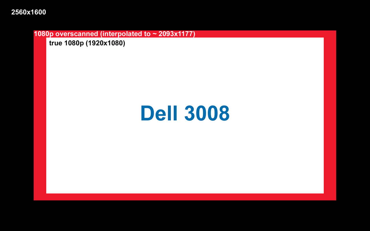

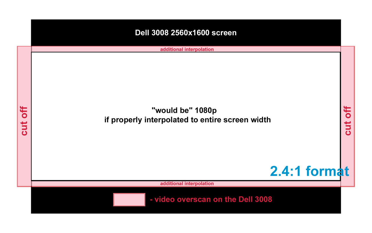

  • Hello,
    please find attached:
    1.The scheme of the Dell 3008 overscan problem from comparison Blue-ray movie scene ("300") shown on prad.de review vs the proper view of the same scene. This is what really happens when 1080p is dispayed on the entire screen.
    2. The scheme of what we can expect - same problem in 1:1 mode. This is very likely but still to be confirmed or denied.
    Thank you.

    The image of Blue-ray "300" is overscanned and cut - this is a fact #1.
    Note: that was an image in Aspect mode.
    So the scheme #1 is related to this case.
    Overscan is a kind of disease that affects all formats over a particular input.
    It may vary from one input to another but if it is present it affects everything.
    Regarding 1:1 mode.
    You have not provided "300" in that mode which is intended to be the true 1080p.
    So the scheme #2 is what I just assume basing on the fact #1 and let's say medical history of the problem.
    Overscannig in 1:1 may not be as obvious as in the whole screen.
    It may or may not be cut because an excessive resolution gives a safety space (like in an airport - to skid out of a runway).
    There may be 3 cases in 1:1 mode.
    1. Good case - whatever the format is - it is displayed 1:1 dot-for-dot.
    2. Bad case - image is overscanned (interpolated) about 8-10% with correct proportions. It means no true HD - always interpolation.
    And this case is not very obvious. A hard working reviewer would find out what the actual size of the image is. It may be done by direct measurement or by taking an accurate photo, placing it in Photoshop, scaling to 2560x1600 and getting the actual image size easily.
    3. Bad bad case - overscanned AND cut - this is easy to notice.
    I remember your test of 2707 - very careful test of all the analog inputs with a stand alone device..
    In the case of 3008 we have more inputs to check including HDMI and DVI.
    We can expect a sort of overscanning with/or without distortion from all of them.
    I guess this work is still to be done.

  • My test shows no overscan using PS3 player with Matrix DVD (in RGB mode):
    The overscan occurs when the PS3 player video output format is set to Y Pb/Cb Pr/Cr or Auto (even with 1:1 mode).
    Looks like the original 300 image from the test here was taken with the default settings (which actually uses Y Pb/Cb Pr/Cr format).
    I'm not sure why such problem happens with Y Pb/Cb Pr/Cr, but not with RGB. Can it be PS3 issue or generic format limitation, or is it specific to Dell?
