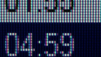

  • Sorry to write in English (I'm from Denmark)
    Just read the review translated with google.
    I was somewhat surprised that Prad.de didn't catch the text issue.
    I owne the HP LP2475w and find the text representation quite bad
    It has sort of a red glow which makes it fuzzy to read.
    I have decided to send it back ?
    Picture:
    You might have the sharpness-setting too high. Is your monitor connected via DVI?
    This Site might help you finding the correct setting.
    Michael

    Original von IcyMike
    Michael
    Of course it's on DVI
    It's an confirmed issue. Some are bothered by it some are not.
    Just surprised prad.de didn't catch this issue since they seem to do very in depth tests
